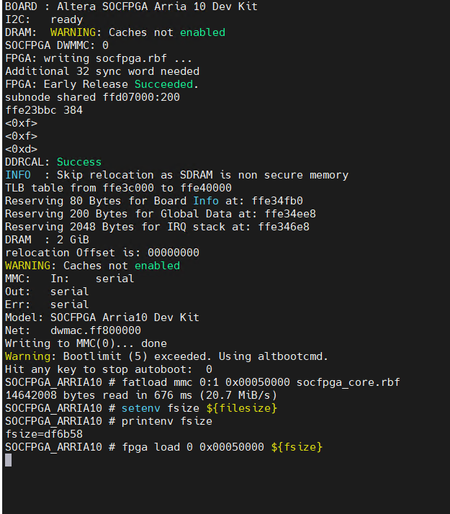

Hi, I am currently working with an Arria 10 board utilizing U-Boot and Yocto on an SD card. Presently, the device successfully boots with a full FPGA configuration and an autobootscript from U-Boot....

I see that you are loading the fpga data to an address that might be in conflict with the uboot code in the RAM.
This might cause the uboot to reset.
May I suggest that you load onto the address pre-defined in the ${loadaddr} variable or an address at 0x2000000.
