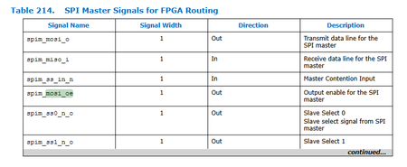

I am trying to wire up a SPIM peripheral from the Arria 10 HPS to FPGA IO pins, and there is one point of confusion in the technical reference manual. In Table 214, the naming of pins, there is an o...
- 2 years ago
So my issue was actually a pin assignment rather than the output enable logic.
After a bit of testing, it would seem for the Arria 10 the diagram in the technical reference manual is wrong. The output enable is active high
Following the signal naming convention not the diagram. The output enable is active high:
assign mosi = spim_mosi_oe ? spim_mosi_o : 1'bz;

2 years agoHi TomCarpenter,
Noted with the respond. I will inform and discuss the issue to the team regarding the matter.
