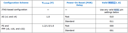

Dear, Sir
We know that AS x4 mode and x1 mode can be configured by MSEL pin.
x4 and x1 AS mode share the same MSEL pin.
Question is: how does FPGA know it should boot with x1 bit wid...
