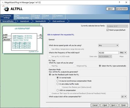

I am using the ALTPLL to generate a 80MHz clock from a 48MHz clock. This is fine. Later when an independent clean 80MHz clock is available I am switching over to this clock by using the clock switch...

As a simple workaround to the dynamic configuration I am spoofing the 48MHz clock as 80MHz in the IP Catalog. i.e I mention inClk0 as 80MHz but give a 48MHz. This is a temporary arrangement until I get the clean 80MHz inclk1 in my application. It is working fine. But are there any design pitfalls in the PLL that would give random problems in field?
