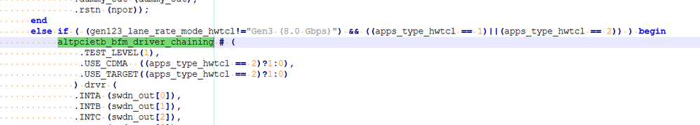

I am trying to understand the example design for the PCIe generated for the Arria 10 device. For the Cyclon V devices i could find the altpcietb_bfm_driver_chaining.v in the example design directory but as for Arria 10 this file is nowhere to be found. I am planning to use this particular file for my simulations with cyclon 10 device.
I could see this file is available in the installation directory of the tool C:\intelFPGA_pro\24.2\ip\altera\altera_pcie\altera_pcie_a10_tbed\verilog
Whether i can use the same in the example design.
