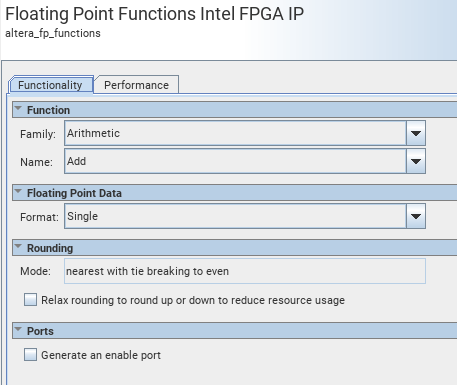

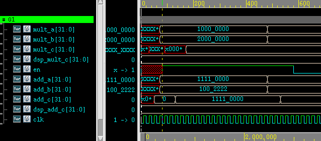

I am trying to setup simple arithmetic unit for matrix multiplication, and I'm using Floating Point Functions ip from basic arithmetic library. I've set up mixed language simulation with vcs-mx, however I'm not getting any outputs when I look at the waveforms. Is it possible that I'm missing some libraries and VCS is not telling me about it?
I tried to use different ip from DSP library but problem remains.
In vcs script I've included all the libraries that you get from Quartus option to generate simulation script.
