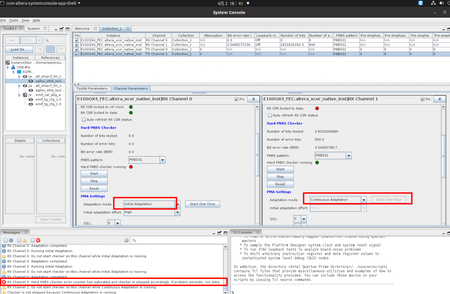

2 years agoAGFB023R25A external loopback 53.125Gbps PRBS checker error after initial adaptation
Hardware board: AGFB023R25A Ethernet Card + 100G QSFP28 DAC cable external loopback. Problem: Use the System Debugginng Toolkits com-altera-systemconsole-app-shell to debug 53.125Gbps performance. ...
Yi
2 years agoHi Jason,
How long is your external loopback module? Firstly I'd like to suggest you try to add a bit TX EQ see if the link would be better first, just in the lower part of the Tx channel parameters.
