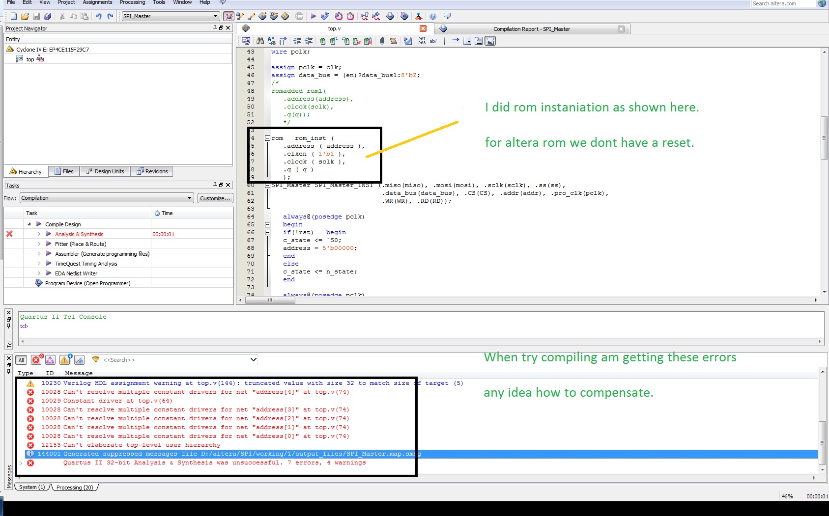

We are trying to implement SPI core using verlig code. If rom is not added and with just the core , code is working well.
but when we try to add rom( on-chip memoery in Altera Sopc), we are getting some errors as show in the attachment.
Can anyone let us know, how to compensate those.
vrv

    it says that you drive address bus twice (or more)
    make sure where address-bus is connected to.
    maybe it is connected to port of on-chip-rom of output.(maybe).
