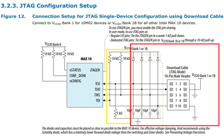

2 years agoABOUT MAX10 FPGA OVERSHOOT CIRCUIT
Hello, I am writing to you regarding the overshoot protection circuit (circled in red in the image). These circuits are used for one-time use only, and I also have space constraints on my PCB...
- 2 years ago
It is feasible to have the marked circuit on the separate board, provided the GND are connected and the VCCIO is sourced from the main board.
Ash_R_Altera
2 years agoHi,
