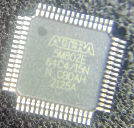

5M80ZE64I5N marking

Thank you for reaching out to Intel Community.
Please note that there dual part markings on MAX® V devices which are intended to show -4 commercial specifications also meet the -5 industrial specifications. You can refer to the link below:
Intel PSG has its authorized distributor to sale Intel devices. If you got the devices from formal distributors, you shouldn’t worry on the device authenticity as the devices must be valid units. Otherwise, we do not ensure the device quality and do not provide further service. You may find the authorized distributor list from the link below:
