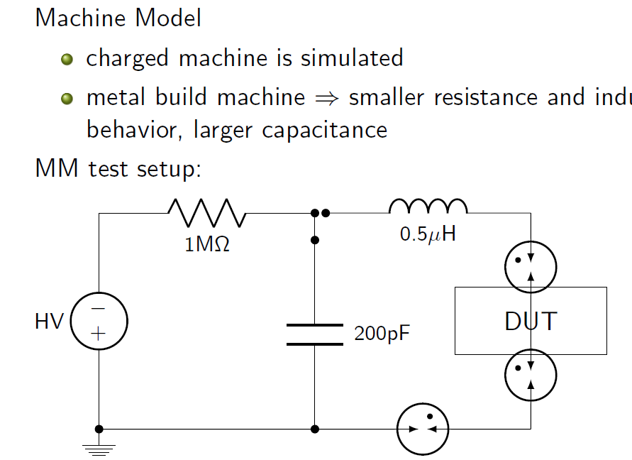

Hi Wei,
unfortunately its the wrong document. I found a reliability report
https://www.intel.com/content/dam/www/programmable/us/en/pdfs/literature/rr/rr.pdf
but it is only added the Human Body Model e.g. Arria 10.
We are looking for Machine Model specifications for the mentioned Arria V! Can you please double check and let me know?
A example below:
I would really appreciate!
Kind regards.
Sven
