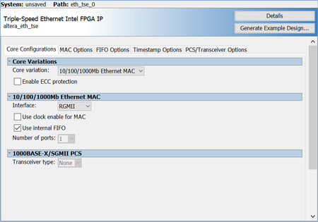

3 years agoWhether Intel MAX 10 will support SGMII Tri speed EMAC
Dear Ma'am/ Sir,
I am using 10M50DAF484I7G. While configuring the IP "Tri speed EMAC", I am only able to select RGMII, GMII or MII interface. I am not seeing the SGMII interface.
Also I am not a...
- 3 years ago
The Intel MAX 10 can support the TSE IP. For further information, please do refer link below, Table 3, pg 8, https://www.intel.com/content/www/us/en/docs/programmable/683402/22-4-21-1-0/device-family-support.html
Besides that, the transceiver type only can be chose when the core variation has the 1000BASE-X/SGMII PCS.
If you want use SGMII, I would like to suggest you to enable the SGMII bridge which is under tab PCS/Transceiver option. SGMII only can run at 1000Mbps. If user want to run at 10/100/1000 mode, only 1000Mbps will be supported by using SGMII.
