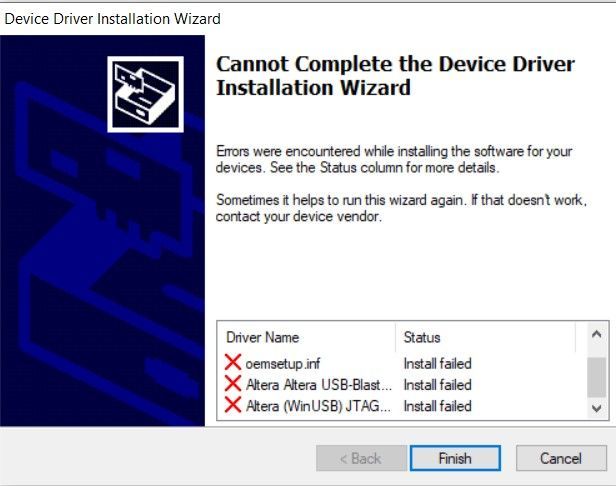

But I have a problem with the JTAG drivers: after the Quartus installation is complete, the Device Driver Installation Wizard fails:

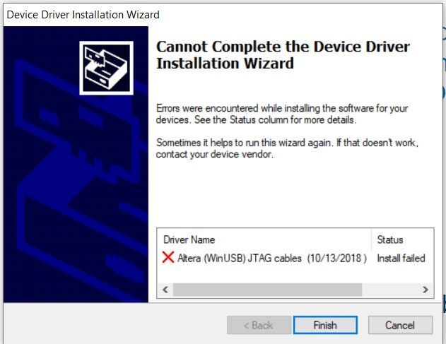

and if I try to run it again it fails again:

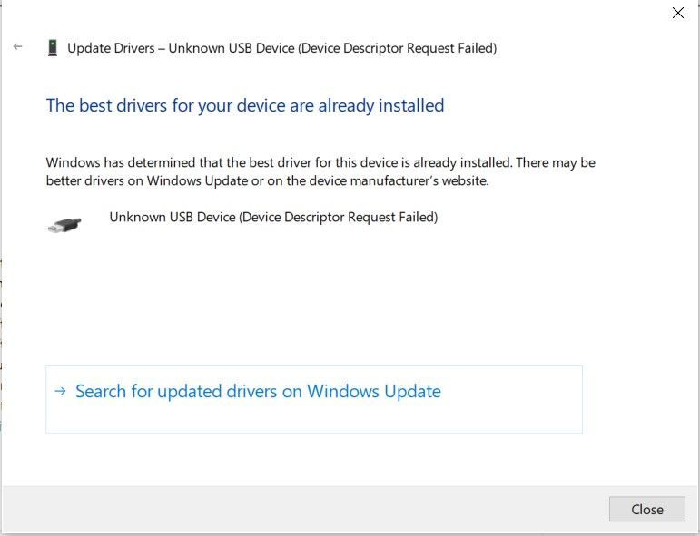

METHOD 1: https://www.intel.com/content/www/us/en/support/programmable/support-resources/download/dri-usb-blaster-vista.html
this method fails, I get the message "The best drivers for your device are already installed":

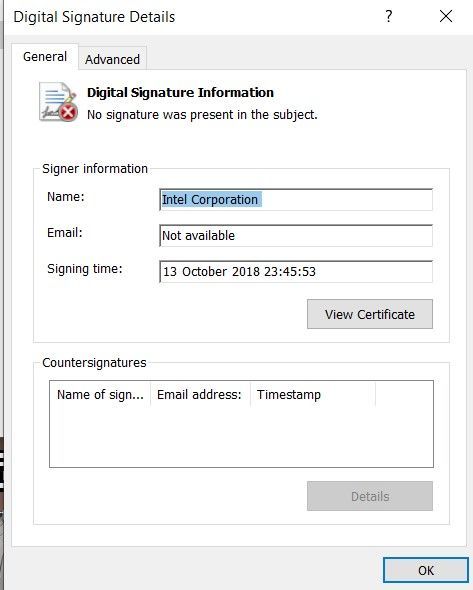

METHOD 3: https://www.intel.com/content/www/us/en/support/programmable/articles/000086243.html
The patch does not run, and also the Certificate information of the driver that I have is different (see picture below) from what is shown in the support page above:

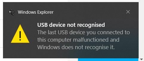

Basically now when I plug the USB cable and power up the board I get this error message:
