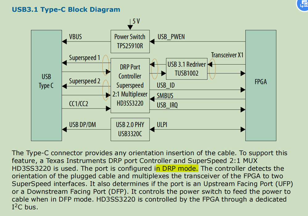

Type-C Problem - Cyclone 10 GX dev kit
I am using this development board. And I need to realize communication through type-C interface, but the official documentation is not clear.
Does anyone have routines or reference documents or how do you realize the communication between the host computer and the FPGA?
