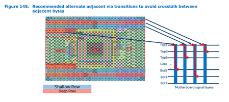

3 years agoTNT Consultation Request ID [3212] - Sequential Routing for Memory AGILEX
Please see attachment for extra details. Based on this Package Ball Coordinate https://www.intel.com/content/www/us/en/content-details/634867/r31b-r31c-3184b-3184c-package-ball-coordinates-agi-027r3...
Christopher_Alvarez
3 years agoWe tried the method, but it is not clear if our interpretation according to the ball out used is correct or not.
What we require is the Ballouts to include details of which pins are shallow or deep row. Can you help us with that information?
