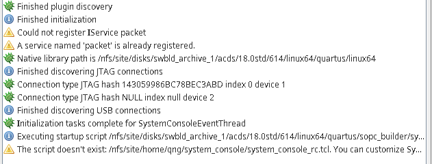

  • ShengN_altera's avatar
    ShengN_altera
    It opens the system-console and the debug info like jtag hash will be printed out in messages windows right? For example like below:
    So far if you mean in system-console, there's no command can straight get the jtag hash.

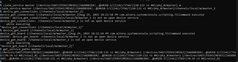

    • covfefe's avatar
      covfefe
      they are all the same model, and do not return any difference unfortunately
    ShengN_altera
    May I know the connections section under System Explorer in system console shows multiple devices?
    Could you try with different lindex like below:
    lindex [get_service_paths master] 0
    lindex [get_service_paths master] 1
    lindex [get_service_paths master] 2
    Sheng
    ShengN_altera
    May I know you able to see different device with different lindex?
