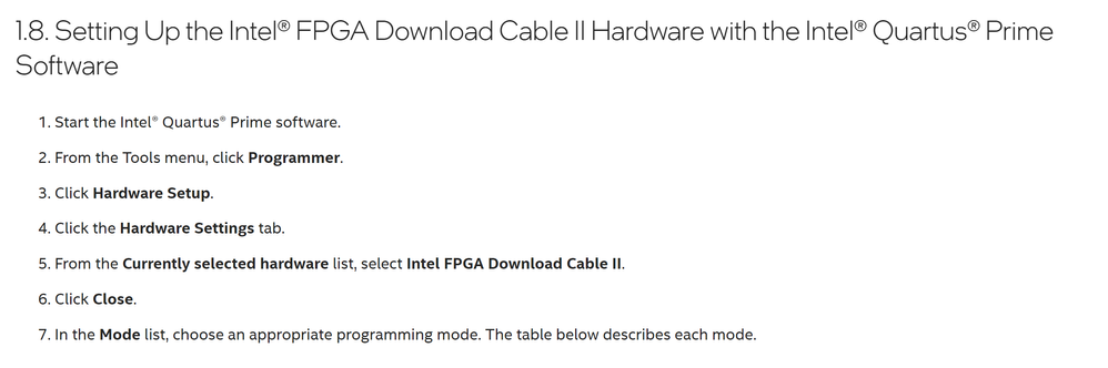

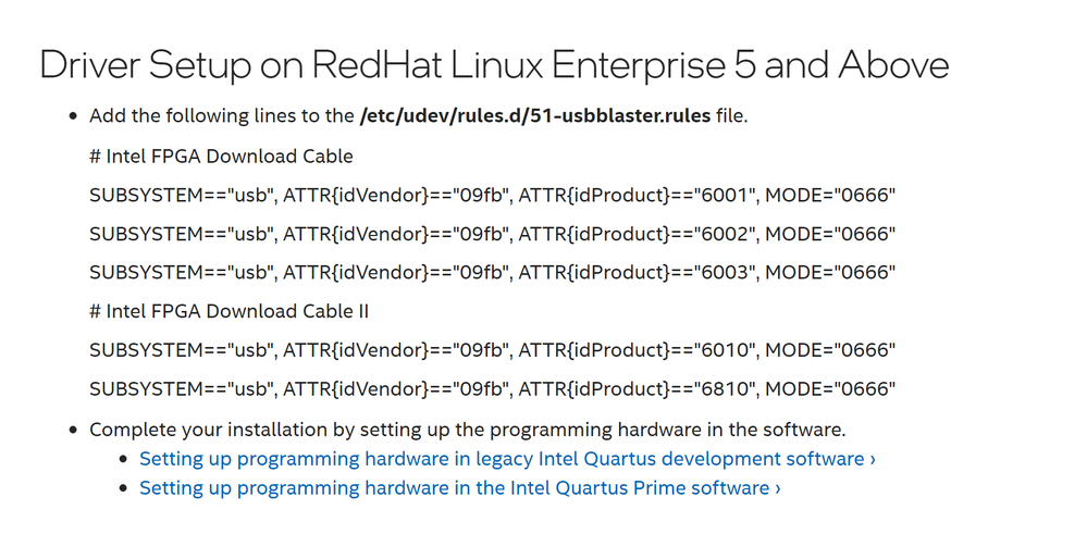

I just followed the Intel Stratix 10 GX FPGA Development Kit User Guide to install the card on Ubuntu 18.04. When I went to Installing the Intel FPGA Download Cable II Driver, it only shows the steps to install on RedHat OS.

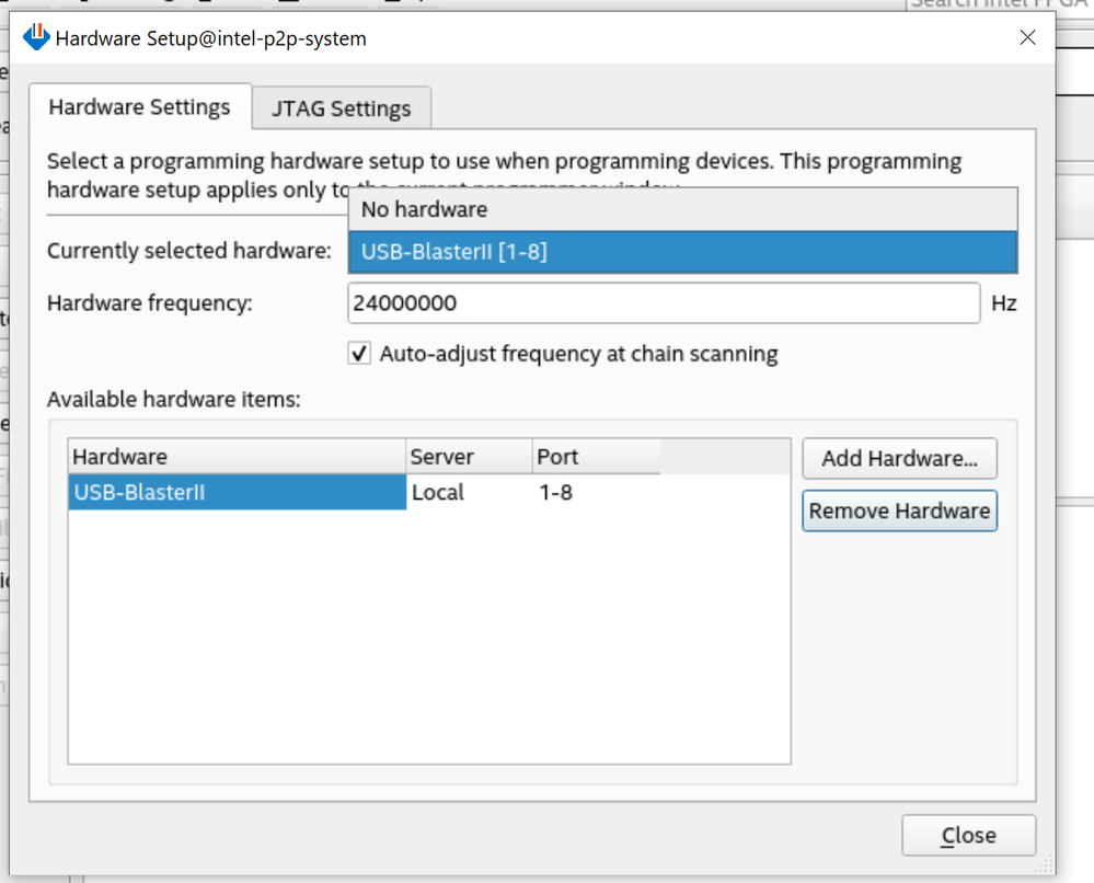

I followed these lines on Ubuntu. While I didn't find Intel FPGA Download Cable II in Currently selected hardware list.
Do you have any ideas about how to solve this issue? Thanks.
  • The USB Blaster II in the list is the Intel FPGA Download Cable II. Please select that.
  • YuanLi_S_Intel's avatar
    YuanLi_S_Intel
