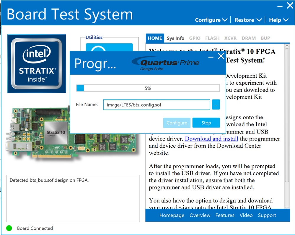

Stratix 10 BTS. Connection Lost. Quartus 18.0 Pro & Win10
I am having issues using the BTS. I am able to run it, get a confirmation that the board is detected.

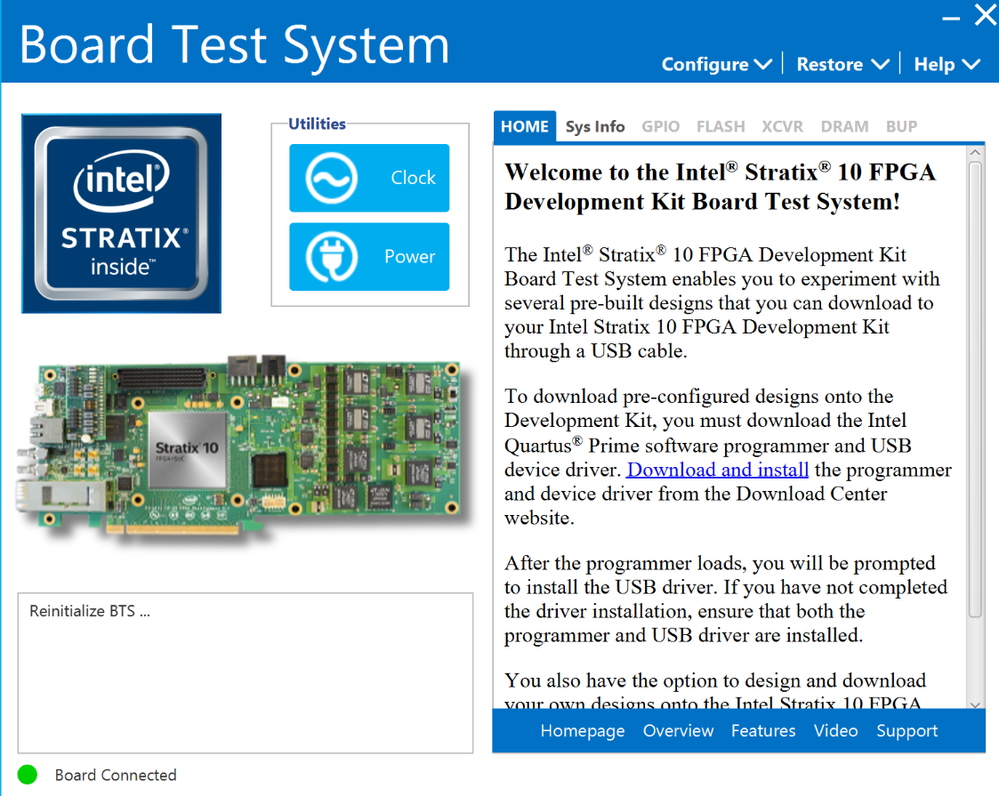

However, impossible to "Configure" any of the images on it. It runs for ~5seconds, percentages go 0-10% roughly, then popup disappears, says
Reinitialize BTS ...
and after a minute I get a message saying
Failed to read production information from this SOF in the FPGA.
Please select compatible FPGA design from Configure option in the menu bar.
If you still meet this issue, please try to restart the BTS GUI.

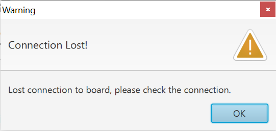

Eventually a messages pops up saying
Connection Lost to the Board
After awhile it says
Reconnecting to the Board ...
No matter what I try (restart the computer, restart BTS, ...) this is what happens. Nothing changes. I am never able to load an image on it or use any of the tabs to control the FPGA.
