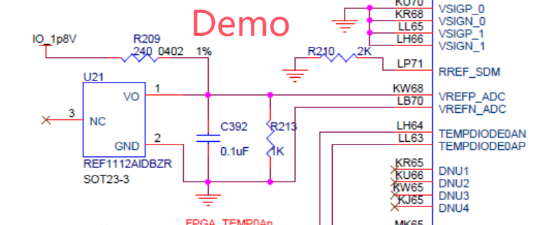

Schematic design about VREFP_ADC and VREFN_ADC
对于VREFP_ADC和VREFN_ADC如何连接?Demo和PCG上的要求不一样

    English : How to connect VREFP_ADC and VREFN_ADC? The requirements on Demo and PCG are different
  • Farabi_Altera's avatar
    Farabi_Altera
    Connect to GND if you dont use ADC , follow DEMO board connection if you use ADC.
