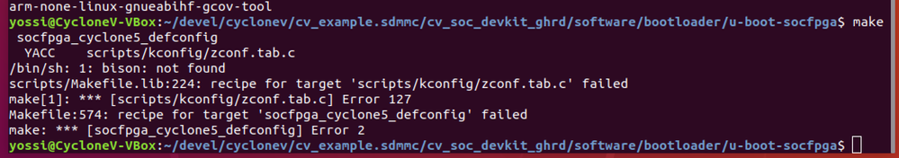

        I tried to follow the exact procedure as said in the workflow
        https://www.rocketboards.org/foswiki/Documentation/BuildingBootloaderCycloneVAndArria10
        For now, I am stuck on the U-Boot compilation:
        Configure and build U-Boot:
        yossi@CycloneV-VBox:~/devel/cyclonev/cv_example.sdmmc/cv_soc_devkit_ghrd/software/bootloader/u-boot-socfpga$ make socfpga_cyclone5_defconfig
        YACC scripts/kconfig/zconf.tab.c
        /bin/sh: 1: bison: not found
        scripts/Makefile.lib:224: recipe for target 'scripts/kconfig/zconf.tab.c' failed
        make[1]: *** [scripts/kconfig/zconf.tab.c] Error 127
        Makefile:574: recipe for target 'socfpga_cyclone5_defconfig' failed
        make: *** [socfpga_cyclone5_defconfig] Error 2
        What should be done now?
        Thank you and kind regards,
        Joseph Gabbay

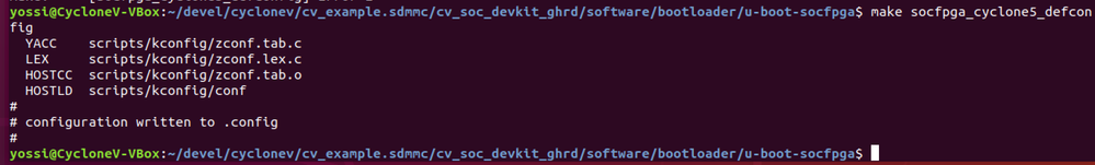

    I took the specified U-Boot version:
    git checkout -b test-bootloader -t origin/socfpga_v2021.10
    Then installed the "Prerequisites" for Linux Binaries, as stated in the procedure.
    Now the command
    cd $TOP_FOLDER/cv_soc_devkit_ghrd/software/bootloader/u-boot-socfpga
    export CROSS_COMPILE=arm-none-linux-gnueabihf-
    works.
    I would suggest telling that in the documentation.
    Kind Regards,
    Joseph Gabbay
