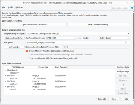

I want to reconfigure the Cyclone 10 LP evaluation board by utilizing the Remote System Update (RSU) IP core. The programming file is arranged according to the picture below.
- 3 years ago
The .rpd contains the FPGA configurations files to be program to the board. The configurations files can be in .rbf/.sof.
