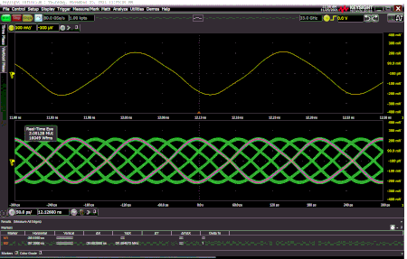

I have a system in which I am using 2 Arria 10 SoC Devkits. One is used as a transmitter and the other as the receiver. In this setup I am using a transceiver port to send data at 10 Gbps. ...

Recommend you to run the internal loopback tests on both the boards. If it works fine, then may be you can try to change the cable. Other option will be to perform external loopback on same board and check the behavior.
