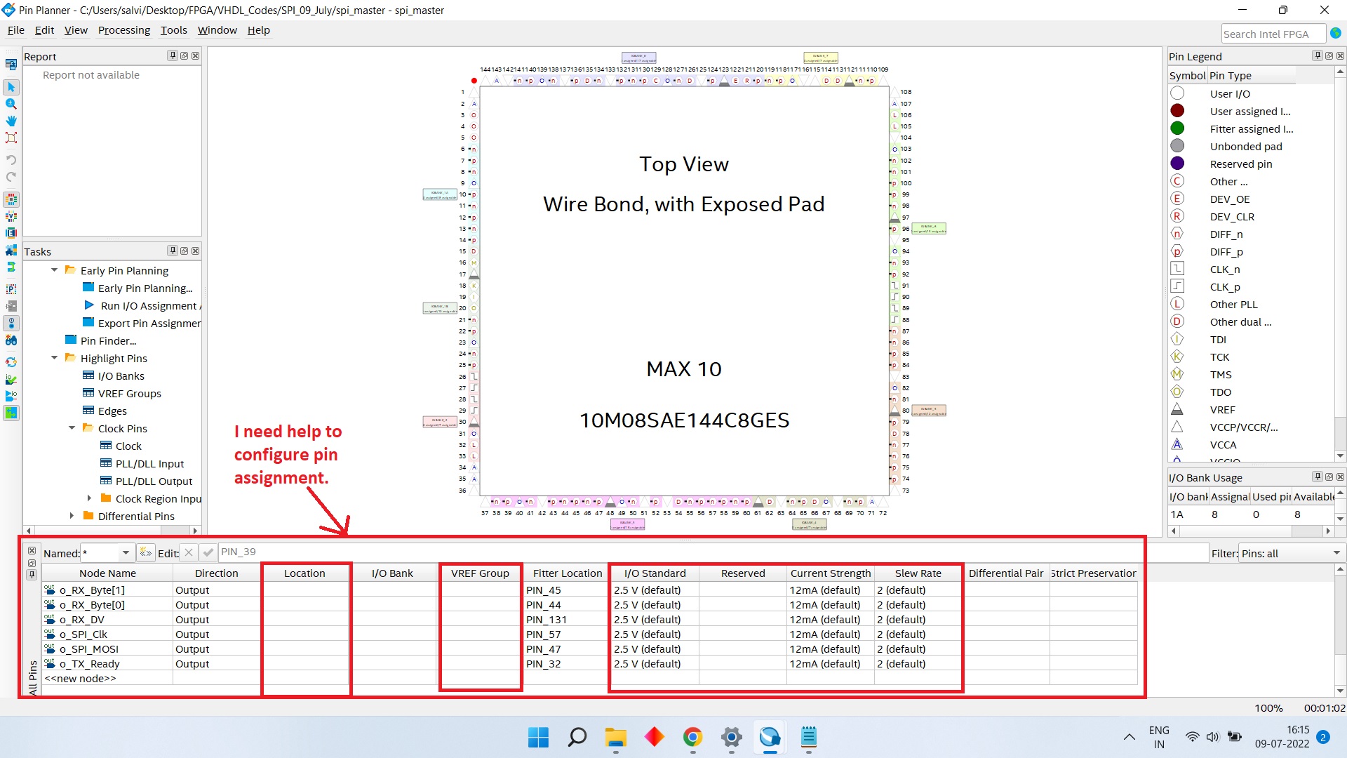

Problem in PIN Assignment on MAX10M50 Board
Hi, I am using DECA ALETRA MAX10 M50 development Kit. I am facing problem in Pin Assignment in Quartus Prime Lite 21. I have writen a code for SPI and I want to see MOSI SCLK and CS signals on oscilloscope. I want to take those signals on P8 or P9 header of development board.
I am attaching screenshots of datasheet and pin planner.

    So what exactly is your question?
    If it's basic Pin Planner usage, you can just drag and drop the top-level signals from the All Pins list to the correct pins as defined in the info for your board (your 3rd screenshot) to set their locations.
    Other than that, was there any other issue?

    You can assign the pin manually using pin planner. Reference of the pin name as you shared in screenshot 155819.
