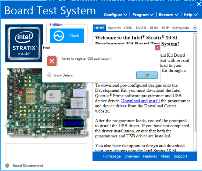

Could you provide the screenshot/error message report?

Two issues addressed to have got the board working as expected now:
(1) Install Quartus prime Pro 18.1 build 222, which is the build to be used for the SW release. However, one could not find build 222 online directly. I got help from Intel PSG team for access to this specific build. After installation, FPGA .sof was loaded successfully and the display was restored.
(2) I had to lower JTAG frequency from 24MHz to 16MHz to get GUI registration done successfully.

- JSu
Here it is...Thank you.
