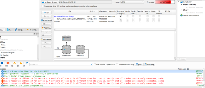

When I download JIC file to the EPCQL1024 on board Arria 10 GX development kit (DK-DEV-10AX115S-A), I get the silicon ID mismatch error.
Is this error referring to the Arria 10 ID or serial flash ID?

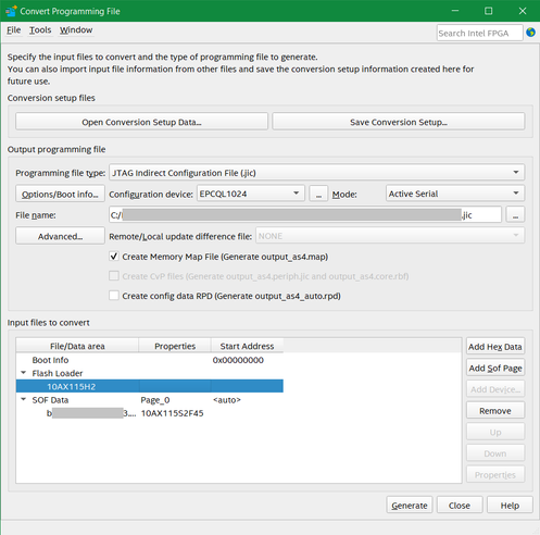

In the programming file conversion, I have tried different devices "10AX115S2", "10AX115H1" and "10AX115H2" on the flash loader. They had the same programming error message.
The programmer is able to run up to 80% and stops when entering "serial flash loader programming" stage.
This is the JIC conversion configuration.
Did I miss something?

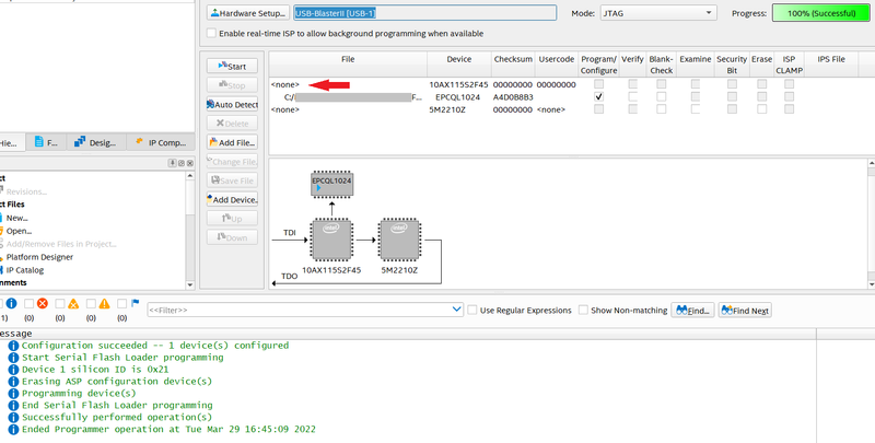

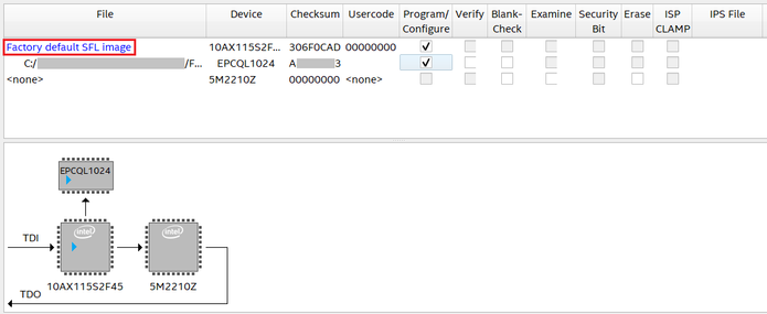

With reference to the Quartus image in my first post at the top, there is "Factory default SFL image" automatically loaded when I "add flash device", add JIC file and check the "Program/Configure" box.
After successfully downloaded JIC file, the "Factory default SFL image" disappeared (refer to red arrow in image below).
Is there a direct way to add this SFL back?
Currently, I have an indirect method by firstly changing serial flash device back to the same EPCQL1024, next reloading the same JIC file, and then checking "Program/Configure". This can reload the default SFL.
Is there a direct and quicker way?

In my test, after I select the JIC file for the serial and check the "Program/Configure" box, the Arria 10 will self populate the "Factory default SFL image" (see the images below). I think this factory SFL image is not having the matching Arria 10 JTAG ID (02E660DD) and hence caused the error.
Do you have the serial flash loader (SFL for JIC) and parallel flash loader (PFL for POF) for Arria 10 (02E660DD)?
Where can I locate this SFL file and inspect the embedded ID? Or can you share the correct SFL file, such that I can change to it in the programmer?

During the JIC file conversion, I've configured the FPGA device but the output is only a JIC and MAP file.
Is the SFL already embedded in the JIC and hence it self populate on the Arria 10 field when I check the "Program/Configure" box? But it shows "Factory default SFL image", rather than the device "10AX115S2" that I configured.
Or should the file conversion process generate a separate this SFL file?
