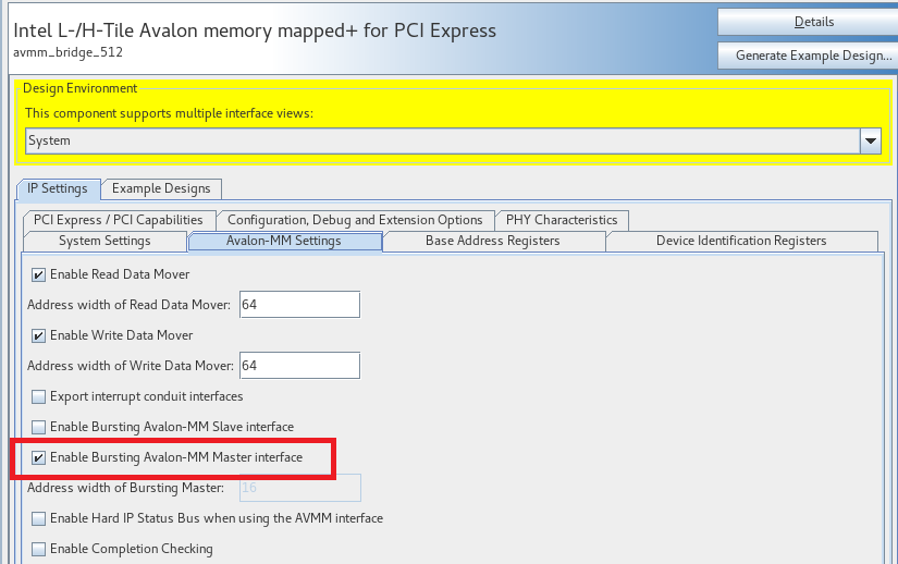

Please try de-select the "Enable burst capability for Avalon-MM BAR0 Master port" (HPRXM BAR0) option as shown below, then re-generate RTL, re-compile and configure the example design again.
Let's see if disabling burst mode for BAR0 allows the DMA test to work because it looks like the HPRXM (burst mode) module and the DMA module have conflicts on BAR0 causing problem.
Let me know your test result after this change.

I resend the picture. Hope you get it.
- He4Forum4 years ago
Thank you. It can bo loaded now. While my Quartus window looks different form yours. Can I just disable BAR0?
If just disable BAR0, "0: Link test - 100 writes and reads" test can pass while "9: Perform DMA" cannot.
Are you using Avalon MM IP instead of MM+? I can test the design for Avalon MM IP to see whether it could work.
- skbeh4 years ago
Contributor
Please disable this Bursting option under 'Avalon-MM Setting' tab and try again "9: Perform DMA"
BAR0 is required for DMA test, cannot be disabled BAR0.
