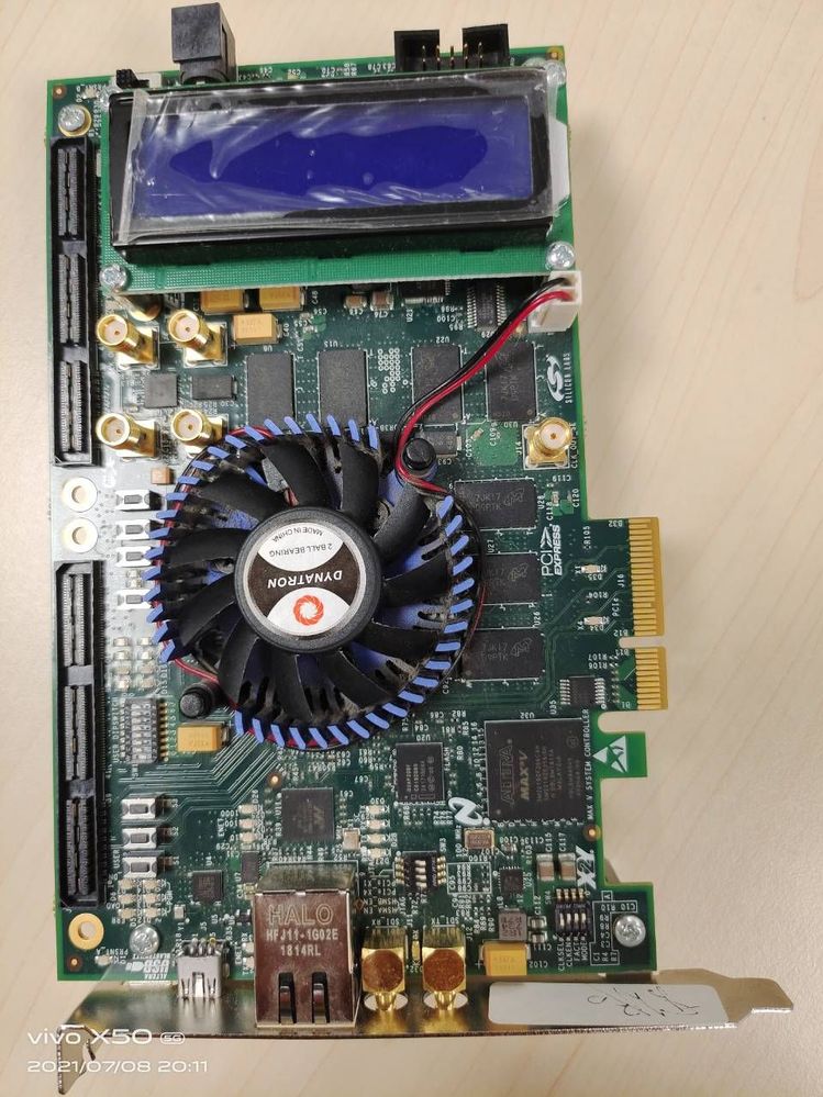

Hi Wani,
Thanks for your reply. For the FPGA image, I think we can keep it as public since I cannot reply to you via my work email because of the security IT policy.
For the Pin3 in J1, the name is HSM_D0. Actually I have returned two Cyclone-v GT FPGA platforms to Intel for RMA service previously, even though the communication and maintenance period is a little long, we got a statisfied result finally. For this damaged FPGA, we suspected it is not a very serious problem, we want to know if it is possible that Intel can provide us guidance to repair it by ourselves by replacing or removing some electronic devices or component.

Dear Sancy,
FPGA is a sensitive device. Once the device is damage (in this case it is shorted to GND/open) it cannot be repaired.
It is advised to handle the FPGA in allowable operations specs and static-free environment to avoid electrical damage.
You may refer to PSG Data Book and the application notes as reference.

Dear Wani,
Is it possible that I returned the FPGA to Intel for double-confirm the issue?I am not sure whether it is Shorted to GND and cannot be repaired, it is just my prelinary adjugement. Thanks.

Dear Sancy,
Please be informed that EOS is not cover under warranty, any of the reasons caused by EOS event will not be approved for failure analysis support.
However, I like to understand more on your issue so we can get some picture on how it can be damage.
Can you tell me the story of this part :
1. How you found it is failed?
2. What kind of test have you done?
Thanks!
Wani
- Sancy4 years ago
In the process of debugging I2C communication using FPGA, my teammate saw the I2C SDA (PIN26) short-circuit directly to the ground, but the specific damage is not known for the time being.
