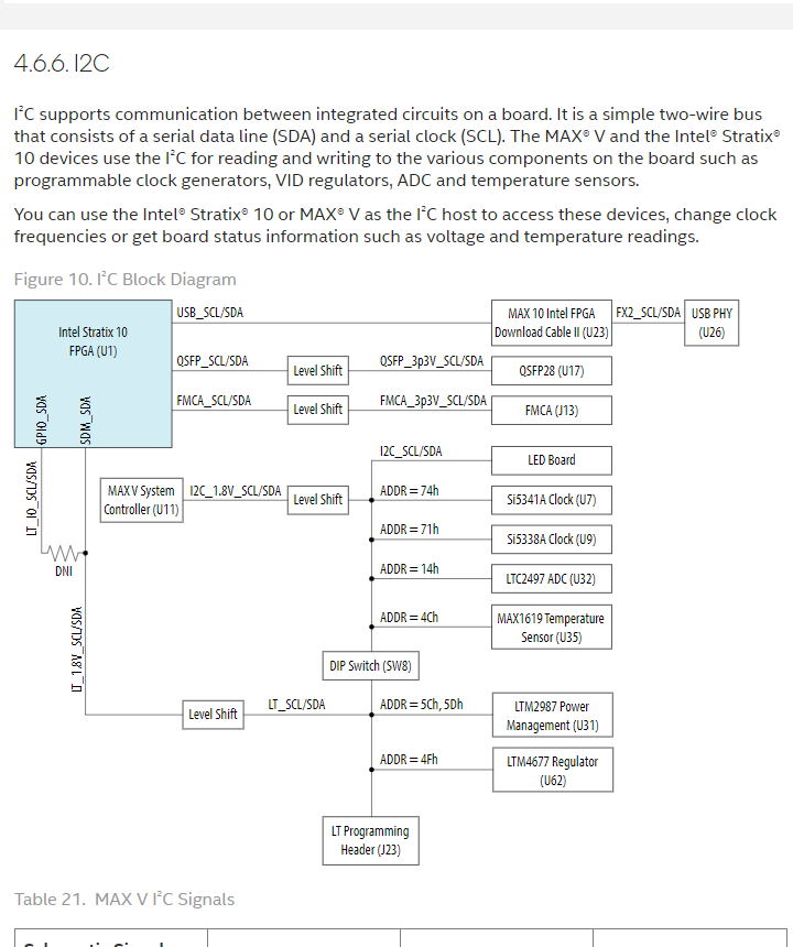

I have an Intel Stratix 10 GX Development Kit.
I am able to access the FPGA, SPI and DDR4 registers from the system console without issues.

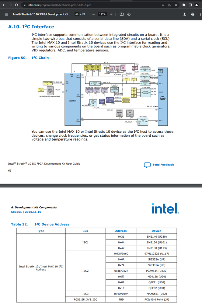

However, I cannot manage to find a documentation showing how to access the I2C devices. Could someone point me to the right direction?
I have tried a lot of things along the lines of:
master_read_32 {/channels/local/m/master_3} {0x00000074} 100
and other master/addresses, but only read 0 at the following offsets in the Intel Documentation.
Any help appreciated.
https://www.intel.com/content/www/us/en/docs/programmable/683674/current/i2c.html

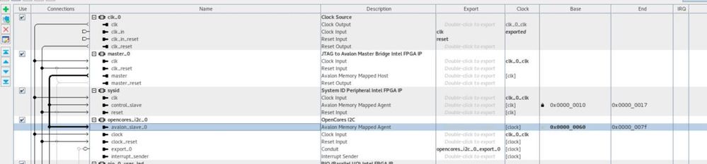

I'm using the basic bts_config.flash image from the Board Test System
- RichardT_altera
I believe the way to access the I2C is the same way as how you usually access the other IP (with debug agents).
Claim the master service and access the memory ranges based on the IP base address.
