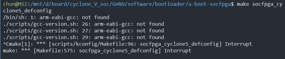

The errors happened when comkpile the u-boot-socfpga with
make socfpag_defconfig using cross_compiler arm-eabi.
WSL2(ubuntu) with/without SOC EDS

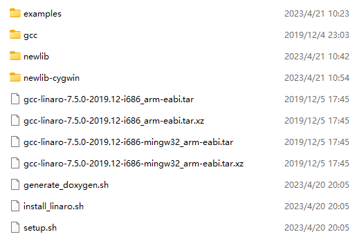

    Also the files are 100% in the correct folder:

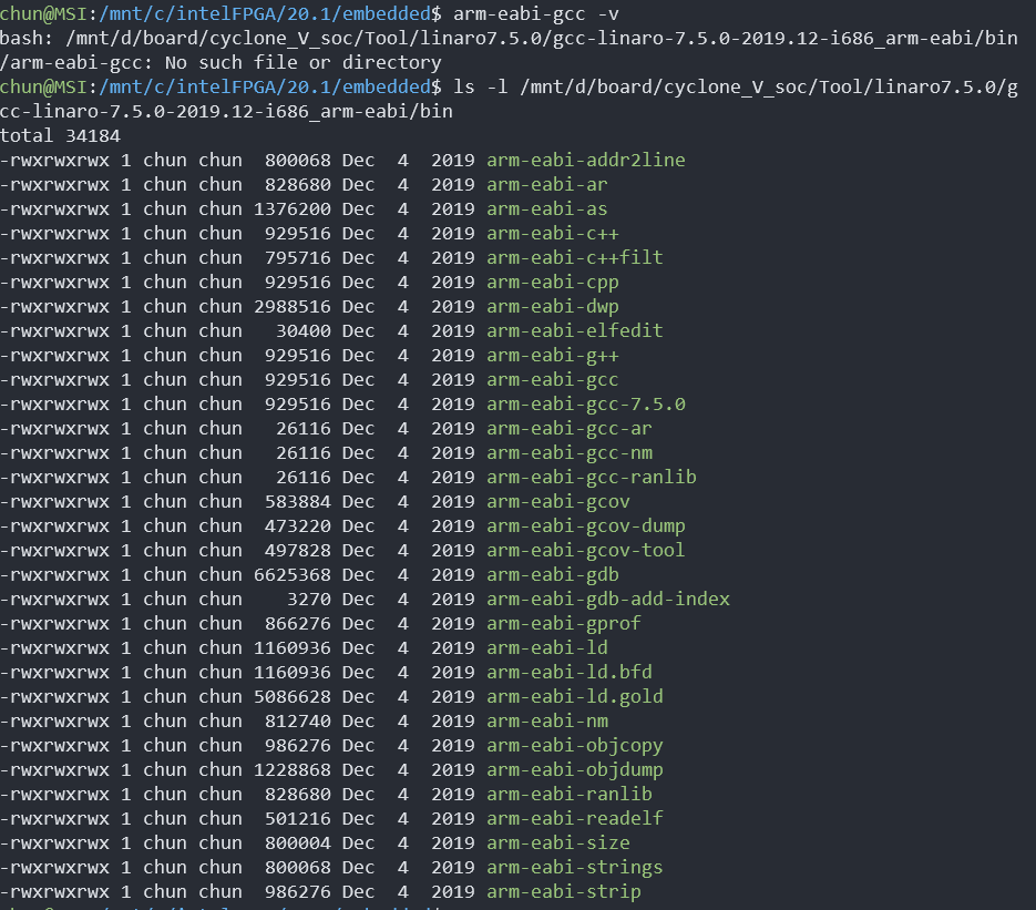

    But when I do arm-eabi-gcc -v
    It said no such file

      It turns out run ./setup.sh will install i686(x86_32) linaro, I installed x86_64 arch tool chain and added the <path to toolchain/bin> to the PATH to solve this problem.
      Also MSYS 1 can solve the problem as well.But MSYS2 can't if your computer is arch x86_64
