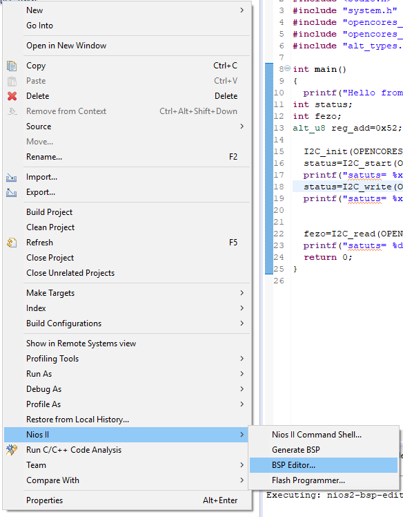

By clicking as below:
-right click the bsp project
-click Nios
-click BSP editor
The steps mentioned as below:
