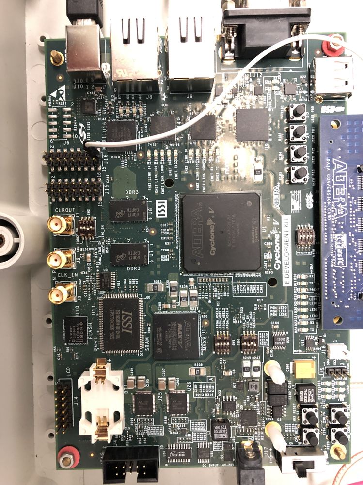

I use C5EFP board, https://www.altera.com/products/boards_and_kits/dev-kits/altera/kit-cyclone-v-e.html

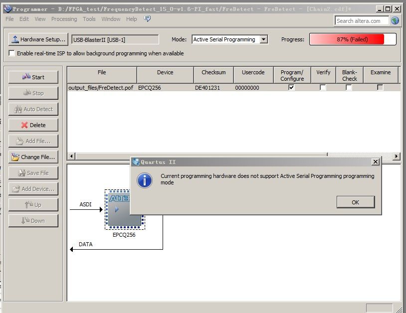

I program the board with .pof file, but get error all the time. Do any Intel technical support can help this?? I attached the image which can show the error and board settings.

HI Bing, Kindly refer link below on how to Convert Programming Files - Page 3 https://www.intel.com/content/dam/www/programmable/us/en/pdfs/literature/hb/cyclone-iv/cyiv-51008.pdf Let me know if you need any further assistance. Thank you.
