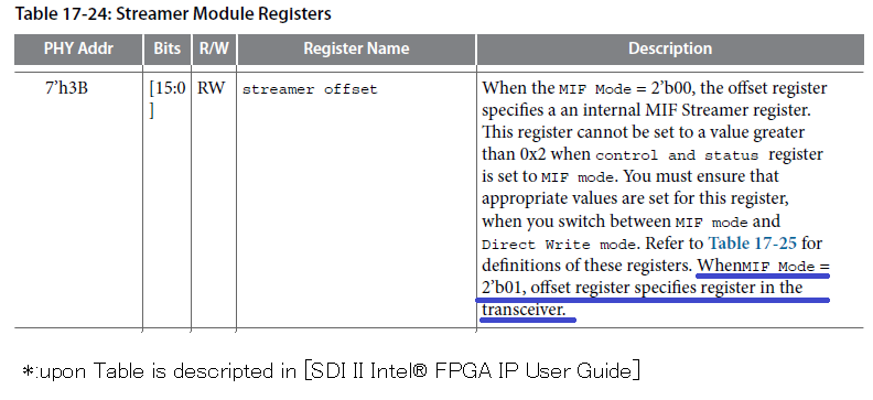

And in the sdi_ii_reconfig_logic.v file there is a in the "SET_OFFSET" state and the "wdata <= reg_offset;" is for write a offset value 0x0000000E("RX_OFFSET_M_L_COUNTER = 4'he") to Transceiver Reconfiguariton Controller.
In [SDI II Intel® FPGA IP User Guide] I foud the information as attached picture image, The offset 0X0000000E is a address point to a register in the transceiver.
I searched the 「V-Series Transceiver PHY IP Core User Guide」and 「Cyclone V Device Handbook Volume 2: Transceivers」, But I didn't find a register description which address is 0X0000000E.
Could you teach me how can I find this register description?
