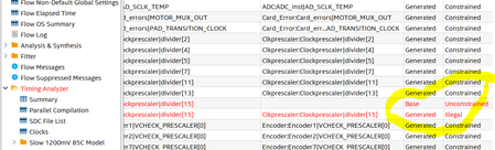

FPGA- SDC creation for 0.00039MHz clk
I have to create the sdc description for 0.00039MHz which was generated using counter logic. FPGA_CLK is 26 MHz, from that i would like to specify the clk value in my sdc file i am trying to give t...

    Instead of using a slow clock for your sensor detection module, you update it only when clk_en is high:
    always @(posedge clk or negedge reset_n) begin
    if (!reset_n) begin
    sensor_state <= 0;
    end else if (clk_en) begin
    sensor_state <= sensor_input; // Sample the sensor input at 390 Hz
    end
    end
    If you need to detect a rising edge of the sensor input, you can do:
    reg sensor_prev; always @(posedge clk or negedge reset_n) begin if (!reset_n) begin sensor_prev <= 0; end else if (clk_en) begin sensor_prev <= sensor_input; end end wire sensor_rising_edge = clk_en & sensor_input & ~sensor_prev;
    This will trigger a pulse only when the sensor input rises at 390 Hz.
