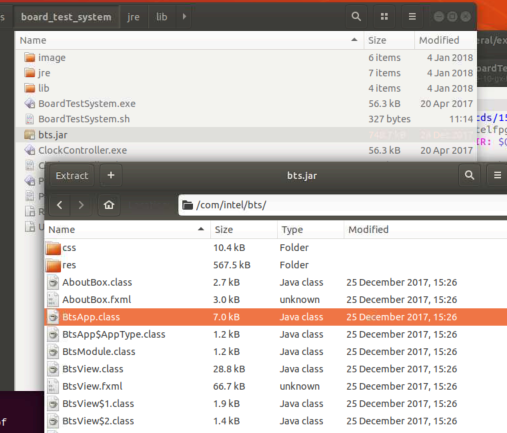

    • NikoR's avatar
      NikoR
      This problem still persist in Quartus Prime Pro 20.2.
      The BoardTestSystem.sh supplied with the cyclone-10-gx-kit-ocllateral.zip seems to be created with Quartus 15.1. Maybe it should have been updated?
      It looks like the class in question is embedded in the bts.jar file:
      Why is it not recognized when running the Java environment supplied with the Quartus installation?
      Are there any options or switches that can be used with the java command to point to where the class is located?
