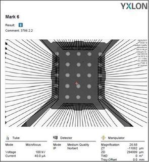

Good morning,
I require assistance to understand the difference in the architecture between two batched of the same product, namely EPM240T100I5N.
The pictures below show the x-ray image & its ...
- 3 years ago
Hi BtsMalta2022,
Just got feedback from the internal. Both designs are normal. The “holes” below are not holes, but dimples on bottom of die pad. It is to enhance mold to die pad adhesion. This is a newer design.
Fakhrul
