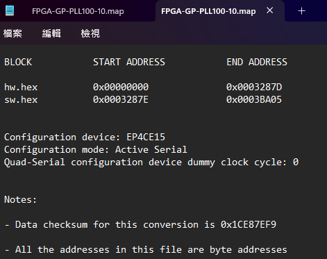

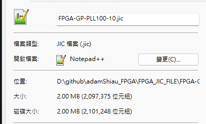

Hi FvM,
In my application, the size of `.jic` file is 2MB.
I convert the `.sof` and `.elf` files into `.flash` files separately,
and then further convert them into `hw.hex` and `sw.hex` files.
Afterward, I combine these two `.hex` files into a `.jic` file.
Upon completing the conversion, I obtain a `.map` file,
with content containing information from `hw.hex` and `sw.hex` (as shown below).
My question is, if this content represents the address information in the EPCQ,
why is there such a significant difference in file sizes?
0x3BA05 corresponds to 244,229 Bytes, which is only 238.5KB.
Adam S
