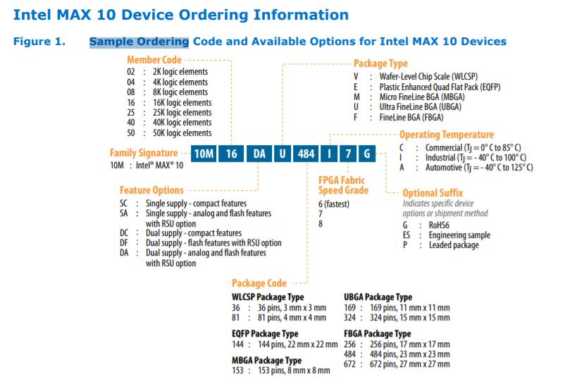

Just a comment/question wrt the difference between the 10M40DCF256C8G and 10M50DCF256C8G: From what I can see in the catalogue and datasheet, they seem somewhat interchangeable? Given that the RTL compiles on both FPGAs of course.
- AminT_Intel
The difference between those two OPNs are their log elements. OPN10M40DCF256C8G has 40k logic elements while 10M50DCF256C8G has 50k logic elements.
Please refer to below figure below from Intel® MAX® 10 FPGA Device Overview:
- OskarvH
Great, then I understood it correctly. We are not using 40k logic elements at the moment, so as long as that's the case, we should be able to use both the 10M40 and 10M50.
