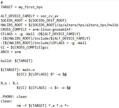

While following the "My First HPS" PDF tutorial from the Terrasic DE10-Nano page, I am having issues compiling the project. This step in the PDF is labelled as "2.4 Compiling the Project." When I use the make command inside of the embedded command shell, I get the message "make: Nothing to be done for '-IC'. I've attached the main.c and makefile screenshots in case someone can spot a mistake. This tutorial is years old at this time and it's likely there are different steps to take in order to perform the compilation with newer software. Anyone have ideas or know of an up to date tutorial for this development board?

I was able to perform the "make" currently without issue.
I compile the Linux Application on Windows, so consider the CROSS_COMPILE = arm-none-linux-gnueabihf-
Can refer to this related issue:
After that, try to compare and re-edit your Makefile text alignment as below:
TARGET = my_first_hps
ALT_DEVICE_FAMILY ?= soc_cv_av
SOCEDS_ROOT ?= $(SOCEDS_DEST_ROOT)
HWLIBS_ROOT = $(SOCEDS_ROOT)/ip/altera/hps/altera_hps/hwlib
CFLAGS = -g -Wall -D$(ALT_DEVICE_FAMILY) --include-dir=$(HWLIBS_ROOT)/include/$(ALT_DEVICE_FAMILY) --include-dir=$(HWLIBS_ROOT)/include/
CFLAGS = -g -Wall -D$(ALT_DEVICE_FAMILY) -I$(HWLIBS_ROOT)/include/$(ALT_DEVICE_FAMILY) -I$(HWLIBS_ROOT)/include/
LDFLAGS = -g -Wall
CC = $(CROSS_COMPILE)gcc
ARCH= arm
build: $(TARGET)
$(TARGET): main.o
$(CC) $(LDFLAGS) $^ -o $@
%.o : %.c
$(CC) $(CFLAGS) -c $< -o $@
