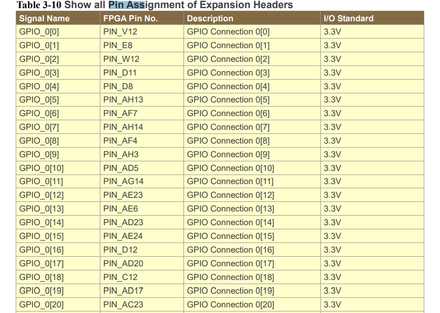

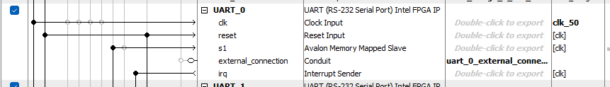

Here are the screenshot examples to use UART to map to GPIO:
1)Exporting as conduit
2) Connect rx and tx to GPIO
3) Example of Pin Assignment assigning to board's GPIO with link of DE10 Nano user(page 29, table 3-10) manual: https://www.intel.com/content/dam/develop/external/us/en/documents/de10-nano-user-manual.pdf
Thank you.
Kelly
Greetings and welcome to Intel's forum.
Yes, it does support connection between UART to GPIO.
The steps are:
1)Export the UART pins as conduit
2)Connect uart rx and tx to GPIO
3)Use pin assignment and assign it to the board's GPIO.
I will attach a screenshot on the example steps for your reference.
Thank you.
Thank you.
Kelly
