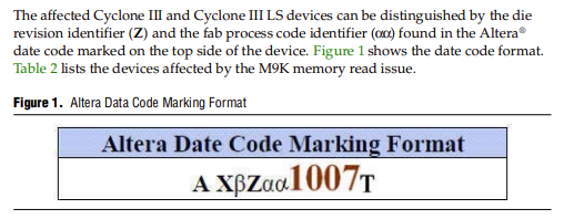

Datecode marking of EP3C16U256C8N
EP3C16U256C8N
I used DC 2131, 2149, 2207 before, and they are Die marking Z1433, Copyright 2009, Datecode marking: G CCABG2xxxA.
Now I bought a lot with DC 2049, but it’s Die marking Z1409, Copyright 2007, Datecode marking: J CBBAA2049A.
I think Datecode marking: J CBBAA2049A is incorrect, may you advise? Thanks.

      Hi Fakhrul,
      i.e.
      Die revision identifier & fab process code is "ABG" for DC 2131, 2149 and 2207; but "BAA" for DC 2049.
      So I question is the Datecode marking: J CBBAA2049A correct. Please advise, thanks.

    Hi Ronnie,
    I just got the reply from the internal experts, he says that based on datecode formula. yes : J CBBAA2049A is correct datecode. For further confirmation, we need lot number.
