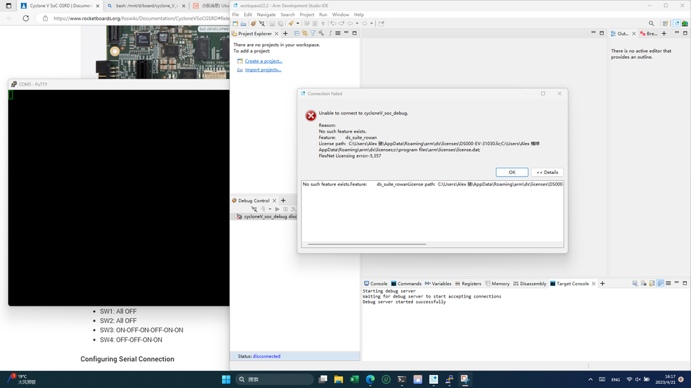

  • CAlex's avatar
    CAlex
    I applied ARM DS for 30 day free license but when I want to debug I got the following error:
    I used the SOC EDS to lanch the armds_ide,
    I set the debug config as followed:
    intel->cyclone V soc->dual core->cpu_0
    I chose USB-Blast and auto HZ, USB 1 was found.
    The tortural Hardware Library (HWLibs) | Documentation | RocketBoards.org
    used the Dstream but my Dstream selection didn't found any device.
    How can I fix that?
    Reguards.

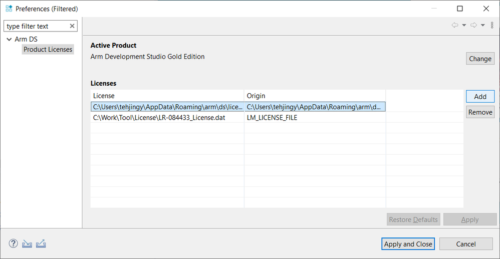

  • tehjingy_Altera's avatar
    tehjingy_Altera
    Hi Alex
    Could you try adding your license file path into windows environmental variable?
    ARMLMD_LICENSE_FILE
    USB Blaster is fine too, you do not need to change it to Dstream.
    Jingyang, Teh

    • CAlex's avatar
      CAlex
      I set the ARMLMD_LICENSE_FILE as you suggested,
      It didn't work for me.
      It searched the AppData/Roaming/Arm/ARM DS 2022.2/license.dat
      But there was no such file.
      I don't know what to do to fix it.
      Reguards.
    tehjingy_Altera
    Hi Alex
    Could you try adding the path to the license in the license manager once again.
    Help >> License Manager
    It is weird, the license is working fine on my end.
    Jingyang, Teh
    • CAlex's avatar
      CAlex
      the weird thing happened to me too.
      The license worked today when I restarted the armds.
      Thank you for your help.
