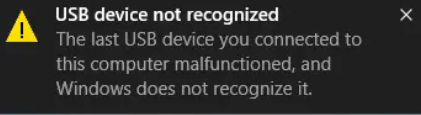

When I plug USBA - microUSB cable to PC and power up the board, Windows 10 OS reports an error:

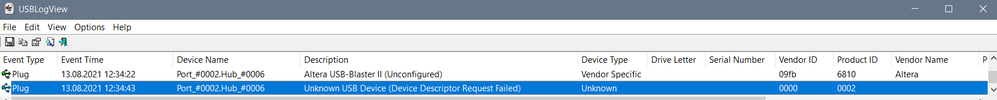

In device manager:
I've tried different PCs, different cables, but the result is the same.
