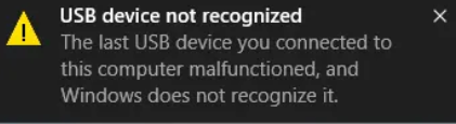

I am working with new Cyclone 10 GX FPGA Development Kit.
And I am not able to use embedded download cable.
When I plug USBA - microUSB cable to PC and power up the board, Windows 10 OS ...
