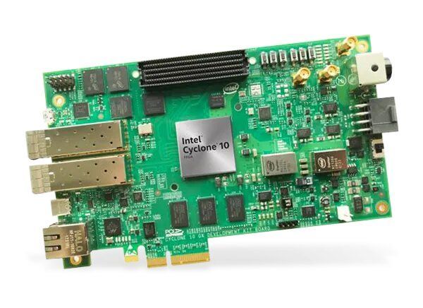

Dear Community,
I want to program the Cyclone 10 GX FPGA Dev Kit with a custom PCIe project and I am having difficulties with the pin assignment (for the qsf file). I was able to determine some of the pin numbers from the schematic (https://www.mouser.de/pdfdocs/c10gx-dev-kits-board-a1-release.pdf), but not all and I am having trouble determining the pin attributes.
E.G.:
What is the pin number of the 50MHz clock?
What is the the Pin-Type and voltage for the user LEDs and user push buttons?
What is the Pin-Type for the PCIe TX and RX-Pins?
Where can I find this information?
Many thanks
