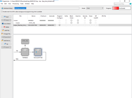

3 years agocyclone 10 GX - JTAG ID is different and dumping failed
The Quartus Prime Pro Edition 17.1 version has been used as IDE.
The reference design is downloaded from intel Design store under Cyclone 10 GX - FFT to iFFT with Natural Input and Output Order Us...

3 years agoHi,
You can check the nSTATUS through scopeshot. Another option is, if you have LED in your design, you can check if the LED is blinking or not.
Aiman
