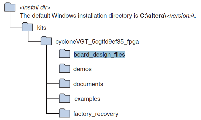

the CVGT Dev Kit user guide says that the Dev Kit comes with board design files, that can be used as a starting point for a new prototype board design.
Indeed there is a folder named board_design_files in the installed CVGT Dev Kit Directory (Fig.).
But there is no .sch-file and if I try to open the .brd-file with Eagle an error is displayed.
So these don't appear to be Eagle files. Where can I find the schematic and with which programme can the files be opened and edited?
Thank you
Fig.: Dev Kit Board Design Files
