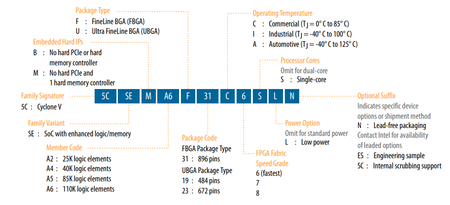

4 years agoCPU1 not found on 5CSEBA2U23C6N (should be dual core)
our Cyclone V - 5CSEBA2U23C6N fails to de-assert the second cpu core from reset. During boot Linux reports the message "CPU1: failed to come online". Software on the SD card is generated by Yoc...
