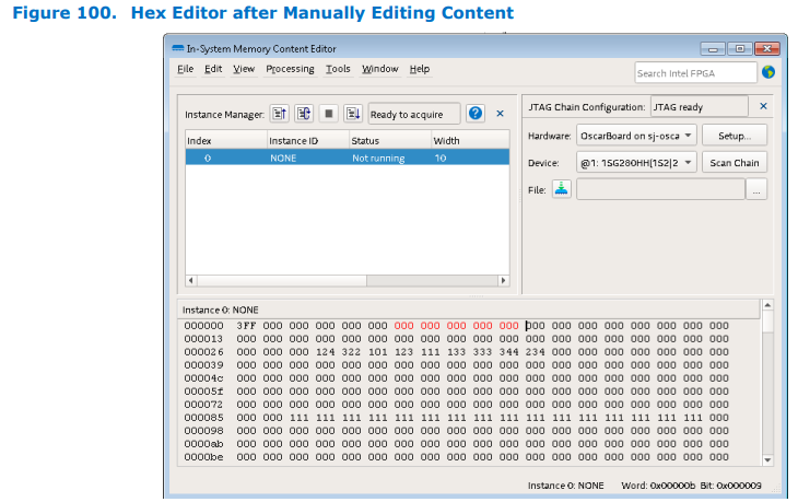

      Are you asking on how to edit the Memory Contents in the ISMCE?
      You can edit the contents of instances by typing over the existing values directly into the Hex Editor pane.
