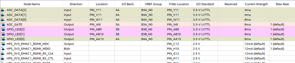

When I look at the "Pin Planner" after compiling, my custom FPGA pins were assigned manually, and a new "Fitter" column has the location of the HPS pins.

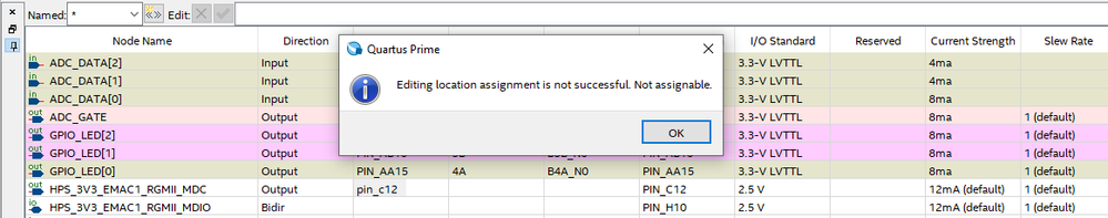

I cannot change the values for "Location" on the Pin Planner, I get an error message.

The warning means that some location assignments have not been explicitly added to the .qsf file. However, hardened pins (like from the HPS) don't need explicit location assignments. The warning is just letting you know of this fact.
- sstrell
It's just a warning. It can be safely ignored.
- EBERLAZARE_I_Intel
