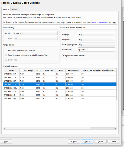

    • _AK6DN_'s avatar
      _AK6DN_
      I have 21.1 Lite installed and it had no problem finding the device.
      You know to ignore the trailing -N, right? It just means lead-free package/balls. No -N means leaded package/balls.
      Otherwise the device die is exactly the same.
